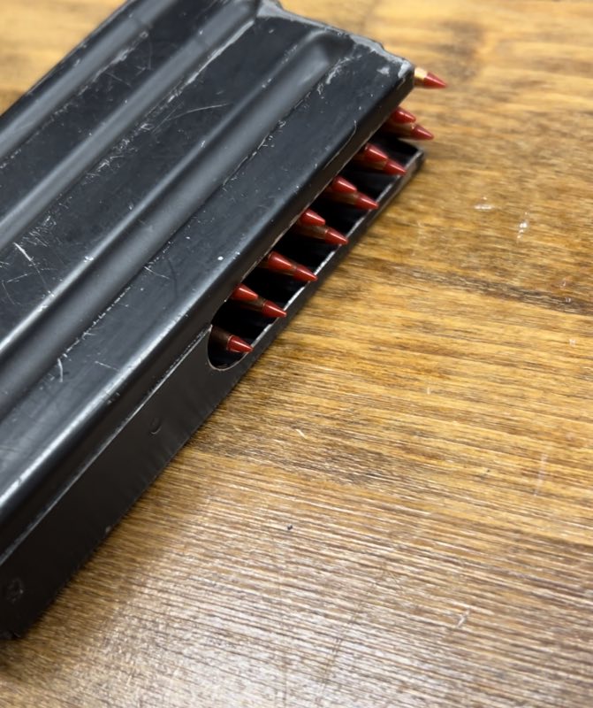

Pro tip: if you cut the front of your mags out, you can load to 2.36.
This is a 73gr eldm loaded to 2.36 oal over 24.6gr varget and does 2750 from my 18in white oak.
