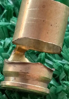

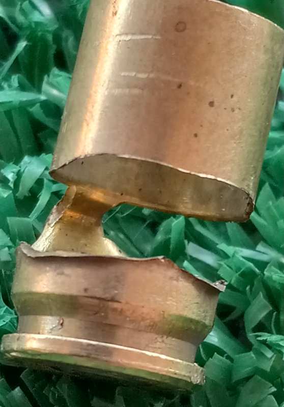

Went out to Table Mesa Rd. today to tune up some of the machines and get my gunpowder fix. Shortly after beginning, 2nd round of 147 grn FMJ reloads blew the base and tried to explosive-weld itself to the boltface, leaving the case wall stuck in the chamber.
Lovely.
Was running a suppressor at the time, so didn't have ear protection on,...SO IT WAS LOUD!!!! Ung.
I've had case separations before in open-bolt guns like Stens and Uzis, but never had one in a closed-bolt system before. At least I didn't get brass splinters embedded in me anywhere, so that was cool. But that pretty much wrapped up the session for the day, and now we get to hunt for our special 9mm stuck case wall threaded bolt I use for pulling such crap out of chambers. I had to use pliers to get the case head off the bolt.

Yes, I think it will be fine. I'm just wondering if the loading was to fault or was the case just too weak from previous use. I suspect it was a piece of brass that had been loaded too many times or too hot and just escaped my sorting out such specimens before I loaded up some ammo that should have been nowhere near maximum.

Out of battery detonation. Heavier buffer and spring to prevent bolt bounce. Something like an 8+oz buffer. It happened to me 3 times before I wised up.

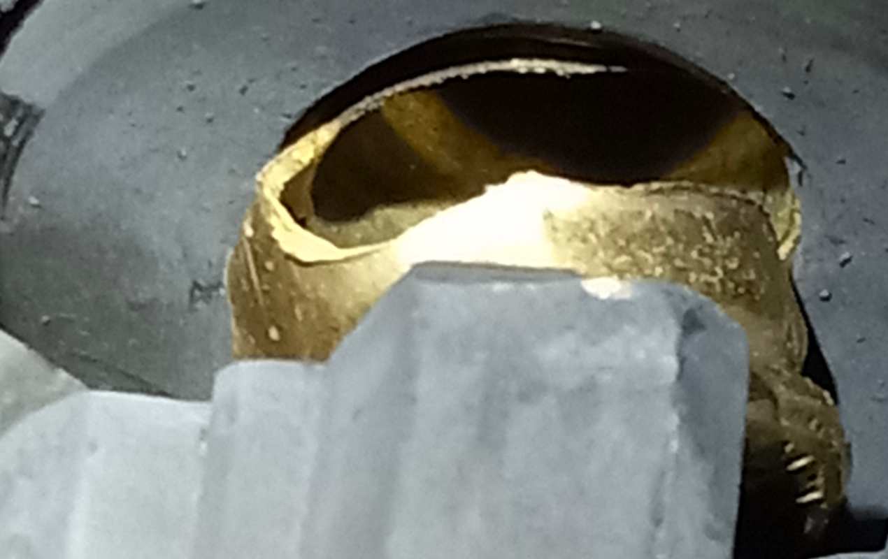

So this is one that is a Blazer round. Blazers are pretty clean after firing. So this one fired and the next round fired out of battery and the plated bullet lodged in the previously fired case. You can see half a case in chamber with bullet.
this is the round that went out of battery and lodged the bullet in the previously fired case.

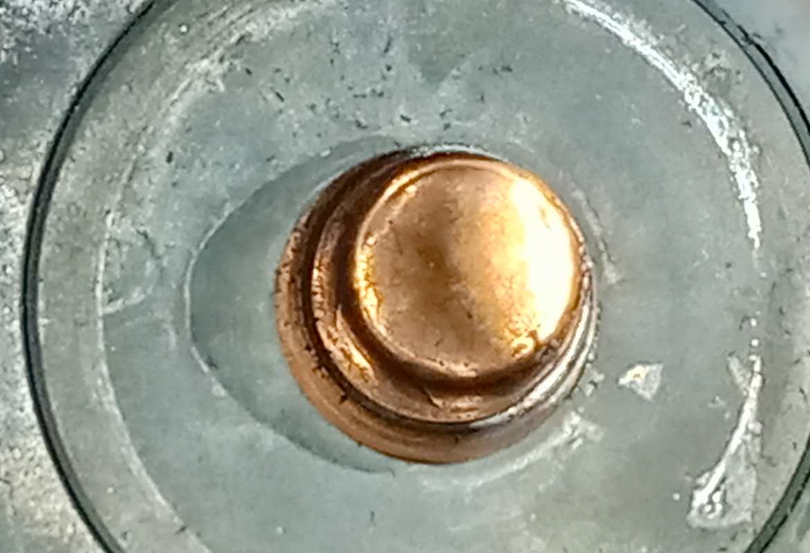

Post by 338lapua »
This is the case after removing it. It blew the Glock magazine out of the mag well and blew it apart. This is shot through the mag well. These pcc rifles can have issues at times.
