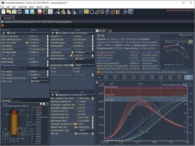

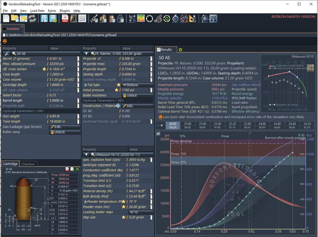

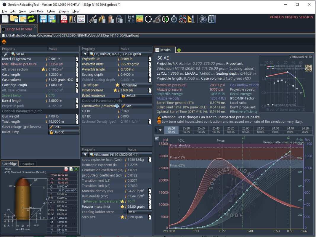

Re: Load data for .50 AE
I've been playing around with GRT (https://www.grtools.de/doku.php) and I like it - but it's free and the support is basically through a Discord channel. There is a similar tool that you can buy that has support but I think it's pretty fringe as well (can't remember it's name).geezer wrote: ↑May 30th, 2024, 9:06 pm I want to load 335 gr Rainier Ballistics bullets. And, I want to use Vihtavouri N110 powder because yrs ago, I acquired a large amount of it from a distributor.
But the only published data for V110 stops at 325 gr , so, anyone know of a program that calculates this combo ?
Yeah I will attempt to contact Vihtavouri but since they don't list this bullet weight, I wouldn't be surprised if they would not want to be exposed to a liability.
I'll see if there are any leveragable models for 50AE and if there are I'll let you know...
Sent you a PM
- BigNate
- Posts: 798
- Reputation: 5
- Location: Phoenix
******NOT TESTED - FOR REFERENCE ONLY!*******
It wouldn't let me add them to the PM...
335gr HP at 26gr of N110 and 1.6000COAL 335gr FP at 26gr of N110 and 1.6000COAL 335gr HP at 24.4gr of N110 and 1.6000COAL ******NOT TESTED - FOR REFERENCE ONLY!*******
Thanks for this ! I'll tap into that site. It is similar to the program I had seen years ago.
Notice the caveat of possible dangerous press loads with Vn110/335 gr...the Vihtavouri testers said 335 gr would not leave adequate case space for n110, so that is that.
But they did test a couple other V powders that would be safe, and sent me the data.
