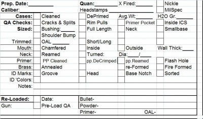

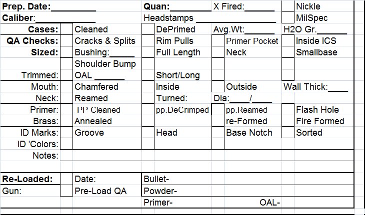

I don't bother with pistol brass but I do prep all rifle brass and it is time consuming... this form accompanies all reload batches.
I use a pin gage to check for loose primer pockets
I only anneal every 3-5 loading's... and as brass gets used x-times I move it down toward lower pressure loads.
Some brass doesn't last long... typically, a majority of my FC, WCC, PMC only get reloaded 1 or 2 times before something gets it tossed.I have many other brands 223 that's been loaded several times

One reason I use the checklist is so i don't forget, also i may process a batch of brass and not look at it again for a couple+ years. I can't remember what I did to every batch all the time. That's also why clean pockets are a sign I did all the other processing first, but if I go to pin cleaning that will have to change (maybe mouth chamfer last?)
I may not do all the items on the checklist during every process cycle but it is on there in case I do (flash holes are only done once- but did I do them is the question).
