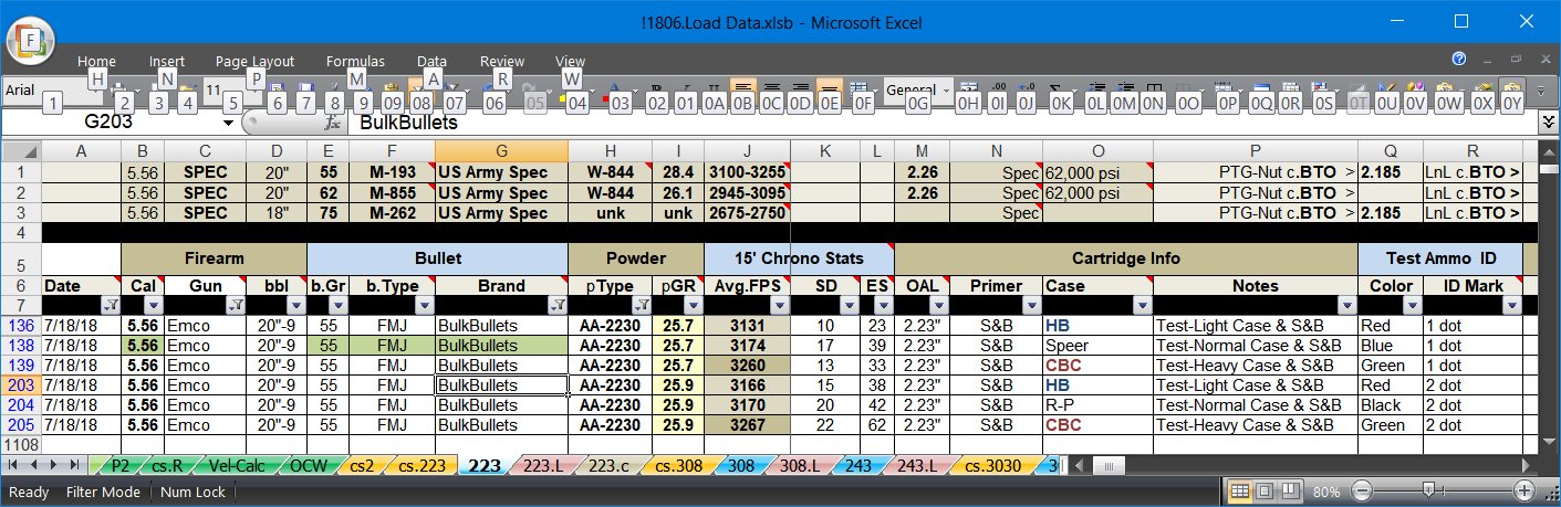

I loaded 5 each of selected head-stamps wit 2 charge weights, leaving all other aspects of the loads the same.
All 30 rounds were shot from the same milsurp 20" AR barrel so they would be from the same chamber.
(click to zoom)
I measured each fired case OAL, dry empty weight and total H2O weight (level with mouth). Individual measurements indicated the .2 charge spread didn't make any difference, so all 10 cases of a set were processed together. Fired primers were left intact throughout. For each set, the same cases were used in the same order and all measurements were repeated to indicate any differences sizing and trimming operations might have. After one set of measurements, I emptied the watered cases and let them sit a few days in a hot 100F+ garage to evaporate residual moisture, so I could weigh them again for the next test.

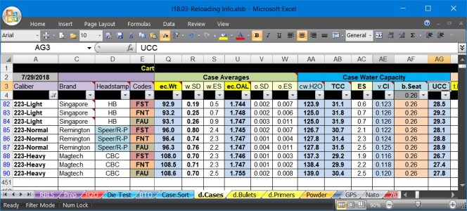

After processing, I noticed the weight of all cases in the FNT set was uniformly .1 higher than the FAU batch. I reasoned that since the body wasn't sized and the necks were lengthened only .001" including some brass removed chamfering the mouth, they shouldn't weigh more than the FAU batch. There could still have been some residual moisture inside, likely the primer area... I let the next FST batch sit a few more days until they looked dry inside. For this evaluation I decided to just compared FAU and FST. Their deltas are far enough apart that .1gr here or there won't make much difference in the conclusion.
Subtracting empty case weight from water filled weight allows you to determine Total Case Capacity (TCC).
This is a Volume to Weight relationship since 1CC of water volume = 15.432 grains weight. TCC is a Gross capacity to the case mouth. However since we have to stuff a bullet in there we have to remove some powder and calculate the Net Useful Case Capacity (UCC).
This will vary with the bullet selected. A short flat base bullet seated .23" will take up less space than a long boat tail seated .45" into the case so when calculating your cOAL, you will have to consider the bullet seat depth too... don't forget the boat-tail (which requires additional calculation). Also, since bullets are given in inch diameters and take up volume, a conversion from Cubic Inches to CC will be required. For my example I am using a .224" bullet and .26" seating depth to arrive at my UCC. I have it set up in excel so once I measure the basic info, I can calculate Ucc for any given bullet and seating depth.
My Excel formula is: UCC= ((AE90-(((3.14*((0.224/2)^2))*AF90)))*16.387)*15.432
(Note, this case's data is on row 90, a different one is on row 89), the UCC formula is located in column AG on row 90.
cell AE90 =case volume in Cubic Inches: converting grains weight to cc then cc to cubic inches.
1 cc = 15.432 gr
1 ci = 16.387 cc
(Tcc/15.432)/16.387= v.ci
cell AF90= Bullet seating depth (you can adjust this based on bullet OAL and the cartridge OAL and enter it directly) used is .26
Here is a table of the test results,
Summary of findings- From reviewing the various data I came to the following conclusions:
o- 3/4 of the light and normal case loads are very close in volume and velocity despite processing changes, and I think they could used interchangeably without issues.
o- The heavy cases are substantially different, not only from the lighter case sets but also from each other depending on processing. They have a 1.14 gr spread in UCC volume between unsized and full-length/trimmed condition, which can account for variance in velocity. I think they need load reduction in order to match the target velocity and avoid excess pressures.
o- chrono data shows the lighter charge to be essentially the same as the .2 gr heavier charge, so I will use the lower change and won't waste powder.
o- With this charge weight, only the heavy cases make milspec velocities over 3200fps from this barrel... oh well....
