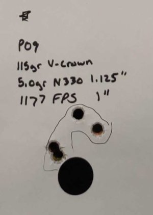

Post up some of your groups, curious how their slower powders work for 10mm. I recently got my hands on some N330 and am really impressed with the accuracy in 9mm loadings. 1st two loads were as attached at 15yds from a rest.knockonit wrote: ↑October 27th, 2022, 4:16 pm Settled on vihtavuori N350 6.0 grains, had loaded it 6.2, 6.4., ND 6.6, LARGER does has quite the snap, but hit same place as lower dose, so, am happy with the results so off we go, load a thousand or so and be ready to rock and roll, have plenty primers, power , brass, and projectiles,
yeehaw
rj
