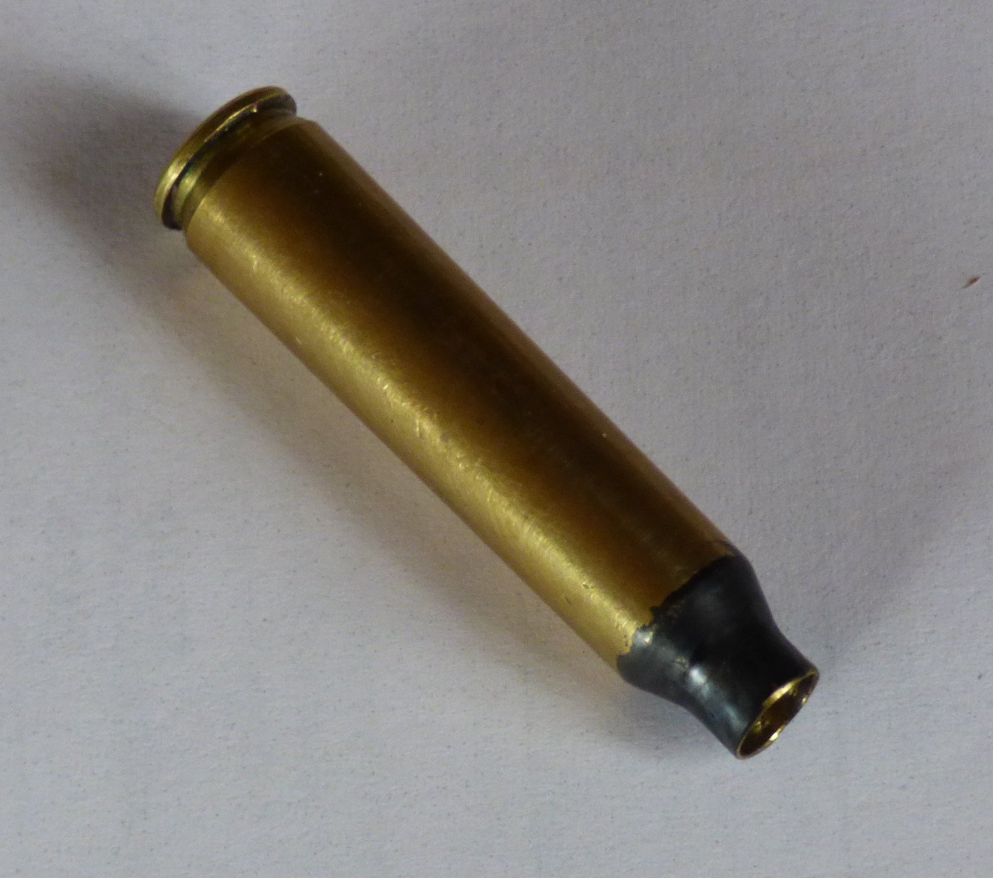

Short cases and the variable case-length after sizing is the only real issue I can see at the moment. I would have the short neck problem anyway. Depending on how many of a particular headstamp I have, i will sort out the short necks into their own group (they will eventually grow longer) and testing has not shown any problem with short necks. I mark them with brass-black and reserve them for short bullets.
Without an expanding button, neck stretch is kept to a minimum, .001 to .003 at most so most of my bushing sized cases come out 1.749 to 1.751 or 1.752 at most. This fine AFAIC. I found leaving the button on stretched cases way too much and re-enlarged the neck by different amounts depending on the thickness of the brass- defeating the purpose of the bushing and requiring neck turning if you wanted to maintain consistency- not a saddle for this horse....
