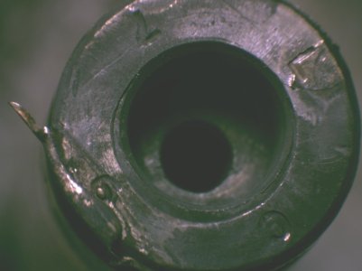

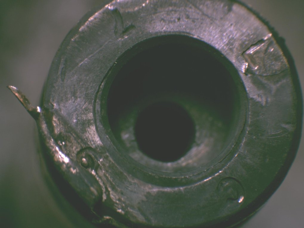

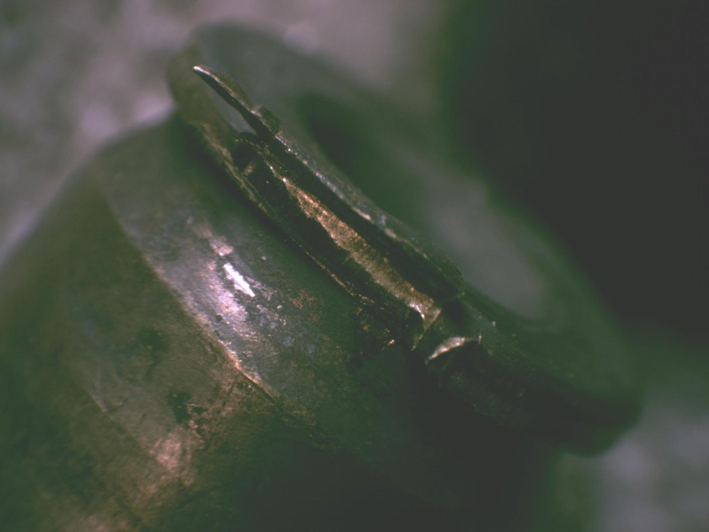

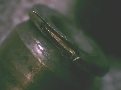

Shot #1 of the 25.5gr load blew the primer completely out, ripped the rim off the case leaving it in the chamber, covered the front of the bolt with burnt powder residue and jammed the next cartridge into the head of the case stuck in the chamber. I used a cleaning rod to easily dislodge the case but found a piece of brass stuck under the extractor. The blown primer was nowhere to be found inside or outside the rifle. My chrono registered 3441 fps and it was obvious something wasn’t right.
I disassembled, cleaned and inspected the bolt and didn’t see any obvious damage.

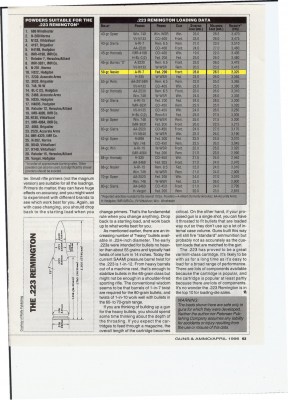

Attached is the article, read it and even compare some of the other loads listed against early manuals (the ones I checked were within good ranges) then tell me if you would trust the data for Re-7 if it was the only one available for the particular bullet you were trying to load…(Nosler Ballistic tips often have different load ranges than Speer-Hornady-Sierra)
I guess I can't attach a pdf so...jpg will have to do

The strange part of that chart is it shows less powder for a lighter bullet...
40gr bullet max RL-7 at 23.5
50gr bullet max RL-7 at 26.5

Looks to me like a clear case of the magazine publishing the wrong data. I have never used Re-7. But I know it's a rather fast powder. Much faster than say Reloader-15.
What makes me think it's an error in the data is that in the same chart (3 lines above), they have a 40 grain Sierra with a lighter charge. That's an immediate Red Flag. A 24% heavier bullet should pretty much never have a lighter charge than the lighter projectile.
