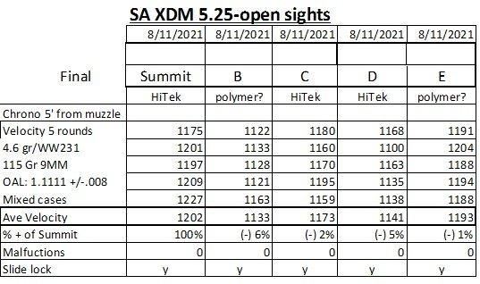

Bullet testing and discount offer. Be sure to see the discount offer from Summit City Bullets at the end of this post.
Recently knockonit and I have been working with Tony Nelson of Summit City Bullets (https://summitcitybullets.com). We were having problems getting coated bullets from a couple of different manufacturers due to either quality issues or their ability to consistently deliver.
For the past last 2 months we have been testing Summit’s 9MM-115 grain bullets and have had great results. Since most of us are just casual range shooters our testing only encompassed appearance of the bullet, ease of reloading, functioning in various firearms and range ammo accuracy. All the bullets performed as would be expected and outperformed or equaled the 5 other bullet manufacturers, (4 coated and 1 plated) to a varying degree. Summit uses HiTek coating and Summit’s coating appears to be more even and “slicker” than the others we tested. How slick? You can see the results in the velocity increase over the other manufacturers.
Bullet weights were consistent, velocity averages were somewhat better and the range accuracy was as good as any other brand we have tested in the past. We tested our reloaded 9MM Summit bullets in seven different 9MM pistols (and one PCC). Used in the testing were a SIG X5, SIG M17, Glock 17, S&W Shield, SA XDM 5.25, SA XDM Elite, Taurus G3 and a Colt PCC.
The ammunition was loaded on a Dillon 550. Primers were WSP and the powder used was WW231. The charge was 4.6 grains, as we have found in the past this is a good midrange load. All brass was mixed range brass. Seating depth was a nominal 1.1111. (some Taurus’s can have a chambering problem past 1.12 with some bullet profiles.) The target was placed at 15 yards. The average group size was 1-1 1/2”, with ½” being the smallest (SIG X5 with RDS) and 1.75” the largest (Glock 17 with open sights). You young guys with newer eye’s, probably would get better results.

Well to add to the information, last week i shot approximately 300 38 spl. and about 400 9mm, just cause is was curious, i actually cleaned gats prior to shooting, as i wanted to see about barrel cleanliness on shooting these coated rounds.
i'd have say there was a difference between these and one other coated i use. I'd say, these actually were a tad cleaner, as pulling swabs, i d kept count and was pleasantly surprised i did not have to spend a gaggle of time on barrel cleaning, usual powder cleaning on revolvers , no difference there, as i'm not a cleaner so to speak they only get the swab when they quit working

I received my 1,000 9mm from Summit. I will note that their coating isn’t perfect, but they are much better than what I have been getting from DG and ACME lately. I decided to load them light as I am using them for holster practice and I was not concerned with accuracy. But I have to say these boolits shoot! They show very good accuracy and cycle well. I have not had a failure to feed or any feeding problems with them. I have been very happy with them.
I liked the 9mm so much I decided to order 2k 158gr 38/357. The following day after my order they refunded 25% of my total with no explanation. So I contacted their CS and they told me they only had 1,500 and not 2,000. So they sent me the 1,500 and refunded me for 500. I got them the other day and the coating looks very good on these. If they shoot as good or better than the DG and ACME boolits I will be placing more orders.
