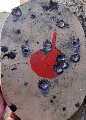

I have a couple AR500 targets. The green tip makes a large "splash" in it. Quit shooting them with it.
Pics of plates and impacts. Lighter marks are 22lr and pistol rounds.
