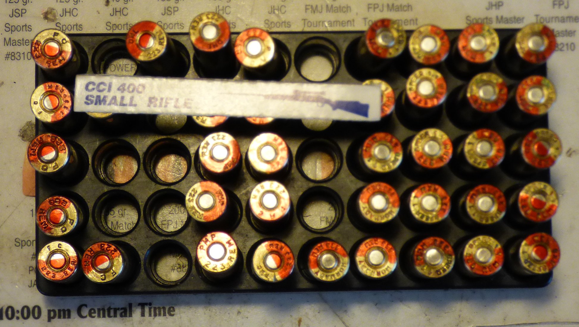

I just got done processing 100 cases from the last range session. After I sort them by HS, I use a .173+zz pin gage to check the primer pockets. Prior to being loaded the last time, very few of them let the gage go in easily, let alone come back out easy (a sure sign of a stretched pocket).
This time about 50% allowed the gage to enter and exit with ease- with very very light finger pressure... this told me those pockets are starting to loosen up since the gage is slightly undersize to a typical primer (.175"). I marked the 1/2 of the head solid with a red marker to indicate a loose pocket... This also signifies (to me) that the case is to be used for a lower pressure load and to use a slightly tighter fitting CCI primer (these loads are often for bolt guns and slam fires are not a concern so I use CCI-400 instead of 450's).
I prime these with a RCBS hand priming tool so can feel how loose the pocket is- if the primer slips right in without any resistance at all -I then try to deprime it by hand with just a depriming stem from a die- if the primer pops out easily(which it usually does if there isn't any resistance putting it in), I crush the case and throw it in the recycle box.
I check these red heads very carefully after the next firing to see if any are past reuse- I rarely have a primer blow out and sometimes I can get a few more loadings out of them.
I can't say how many loads I have gotten out of any of them, but some have blue paint in the groove that I stopped doing several years ago to ID cases. All I know is I'm getting at least one more from em...
