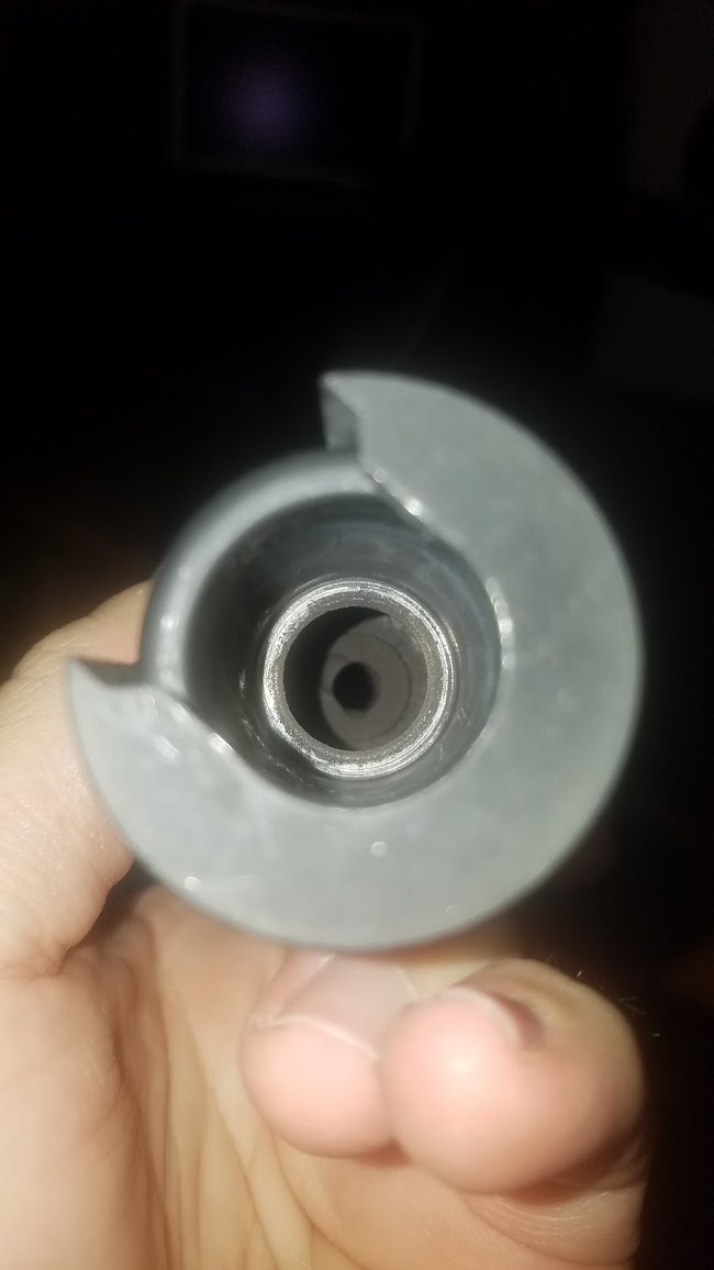

And here's why Gemtech suggests that you only shoot these on rifles that do NOT use crush washers.
I got one of these within months of Gemtech releasing them well over a decade ago and never had a problem until last year. :crying-green:
Oh well. $250 lighter and 3 months later it's back in my hands, re-cerakoted and looks new again. Damn those crush washers.

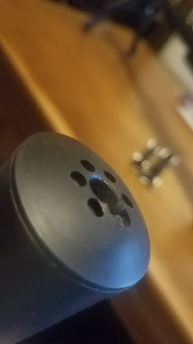

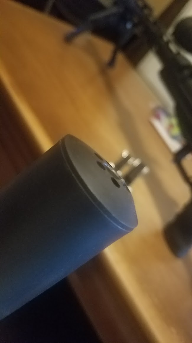

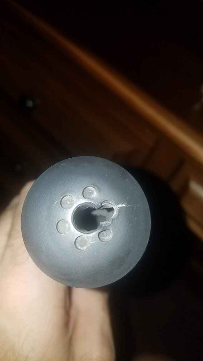

sooo... a few years ago, my third can -
for whatever reason, I tried to save a couple $$ and bought a cheap 5.56 can ($250 I think + stamp). It was mfg'd by a local SOT who's no longer around.
I had some family visiting from Chicago and let them have some fun. She ran a couple magazines fairly quick, and what turned out to be steel (freeze plug looking) baffles got soft.
If you haven't seen one, here's what a baffle strike looks like on a 10.5
You get what cha pay for!
