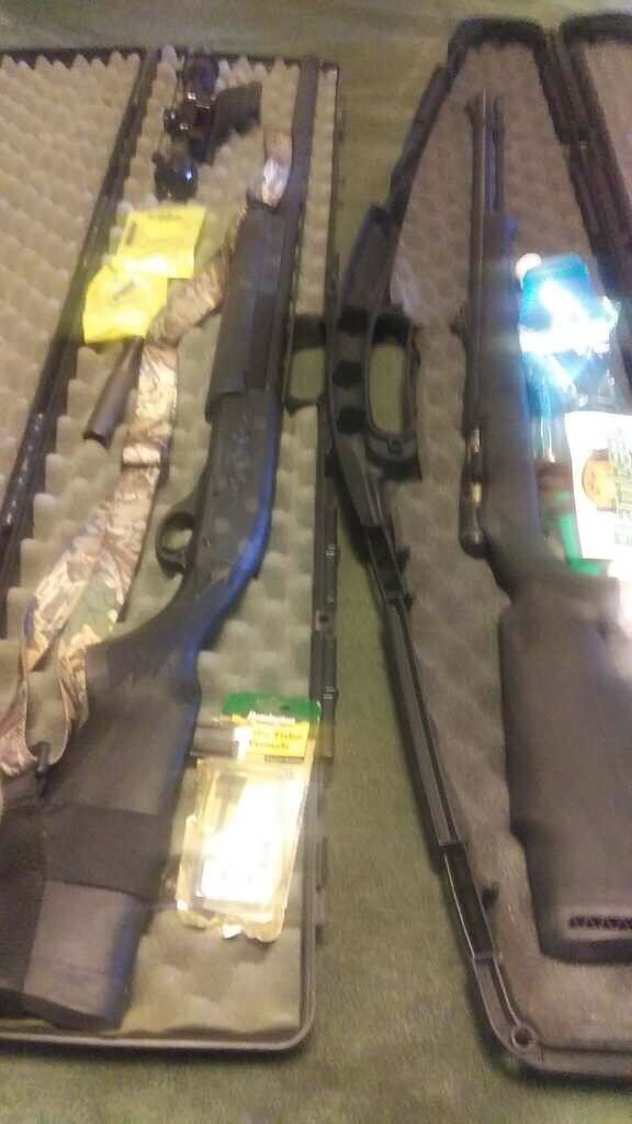

This is the only picture I’ve seen
AZ_Five56
Posts: 1462
Reputation: 12
Re: Remington 1100
Post by AZ_Five56 »
That's the serial, not the model number.
The prices are all over the map. I'm seeing them from $500 and up. For the synthetic model, I think they're on the lower end of the value spectrum. I even see one on Armslist from an FFL in Portland going for only $399. That seems extremely cheap to me for ANY 1100. I think it's probably worth $500-550, but I'd be interested to hear others opinions as well.

The serial number you listed is not from a magnum receiver.
1100's in decent condition are selling from $500 and up depending on what it is.
The one in the picture ( in my opinion ) is in the $500 range if it is what you want.
