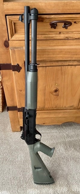

The panzer m4-gery with some new clothes and proper magazine tube all 922r’d up. Looking forward to finally shooting the thing.
