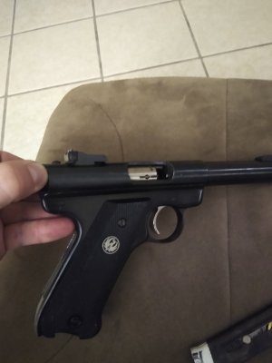

New to me, but not new (made in 1980).
Took it apart to get more accustomed with it. I've disassembled and reassembled several pistols that aren't considered easy (tokarev, cz-52). But they weren't kidding when they said maintenance on a Ruger 22 is tough!
Came apart no problem but I spent 45 minutes and tons of curse words trying to get the pistol reassembled. Couldn't get the part that pulls out of the backstrap back in for the life of me. Finally got it back together and now the pistol won't cock? Can only pull back about half way. This thing is driving me nuts.

I remember having the same difficulties assembling my Ruger MK 1 for the first few times. Below is a link to a Ruger Assembly manual I found online. You might not be catching the hammer when you reassembled it.

Got it back together and functioning but I'm still not sure how or if I will be able to do it again

Very common problem for new Ruger owners. Watch 2 minutes of this video on assembly. I started it at the appropriate spot. If you lean the gun muzzle up at this point the arm falls in the correct spot. If it doesn't it will not cock, just as you described. If you ask how I know, a friend told me.

Have the same gun! My first handgun. Can’t really explain how I do it put when you insert the main spring housing piece flip the gun upside down. Then tilt the barrel down as you insert it. Once it’s in tilt it back so the hammer strut seats in the pocket. Then close it up, you’ll feel the tension and latch. I think that’s the method. Still have it but don’t shoot it that often. Teenage me could assemble it with my eyes closed. Must have been some John Wayne movie influence!

Once you have done it a couple times , it is not that hard.
After awhile you will get the hang of it.
You can also install a hammer strut support to make it a little easier.

That is how you know you assembled it incorrectly. You need to get the hammer strut in the top cup of the mainspring housing like others have said. Once you know what you need to do, it is easy and you wont have any issues again.
