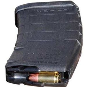

          For me, the most reliable feeding 9mm AR mag system has been the EndoMag conversion of Magpul magazines. The feed ramp geometry is not a radical angle and is very gentle in delivering hollow-points to the chamber. The neat thing is that you can use a standard AR15 lower and no need to drill and pin a conversion feed block in the magwell to use Glock or Colt/Uzi mags.

          Suck My Glock wrote: August 19th, 2022, 9:50 pm For me, the most reliable feeding 9mm AR mag system has been the EndoMag conversion of Magpul magazines. The feed ramp geometry is not a radical angle and is very gentle in delivering hollow-points to the chamber. The neat thing is that you can use a standard AR15 lower and no need to drill and pin a conversion feed block in the magwell to use Glock or Colt/Uzi mags.
          Thank you! I thought about going this route as I could use my AR-15 lower. It's good to know these actually work. I watched some videos and one person did a review on these and another brand. He said these were reliable but I still had some doubts lol. I debated it for a bit and decided it would be nice to have a dedicated AR-9.
          If you don't mind me asking what are you using for your upper? Which barrel and bolt? Are you using the standard AR-15 buffer or something different?

          Posts: 8919
          Re: AR-9 Build Questions
          campinginaz wrote: August 19th, 2022, 10:36 pm
          Well, I went a route most others have not, and I built my own radial-delay CMMG Banshee from parts back in 2018 because it was cheaper than buying the whole pre-made weapon. I also wanted a short 5in. barrel to keep things compact and to utilize as large a diameter carbon fiber free-float tube as possible so as to also act as a shroud over a suppressor. At that time, CMMG sold just the barrel and bolt, and you had to come up with your own upper and other bits. CMMG advised that building one of their Banshees required a non-milspec upper, with larger ejection port dimensions, to ensure reliable ejection of 9mm cases. I can't recall now where I ordered mine from, but it was from some cheapo parts house, as I was trying to do this as cheaply as possible. Other than the CMMG Banshee bolt and barrel, nothing was high-end brand name components.
          I went with the radial-delay system specifically because in researching AR-based 9mm systems I was aware of the stresses the plain blow-back guns were having difficulty with. The bolt velocities were breaking hammer pins and elongating hammer pin holes in receivers. Low bolt assembly mass was making use of suppressors problematic due to the risk of prolonged pressure dwell times rupturing cases as they began moving rearward while still under combustion pressures. Recoil spring and buffer weights, in an attempt to compensate for these things became a complicate game of mix and match. Some sort of locked or semi-locked bolt system would seem to solve all this, and the CMMG radial-delay system does that. I was able to use a standard carbine buffer and recoil spring from the my spare parts bin. Everything about the build was made easy because of the radial-delay system.
