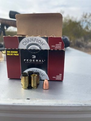

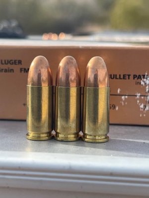

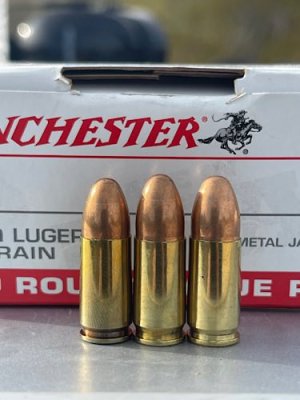

Re: Bullet/crimp jump Ruger LCR 9mm?
Some different ammo. Winchester white box was minimal, PMC bronze showed none, and federal…..omg!
