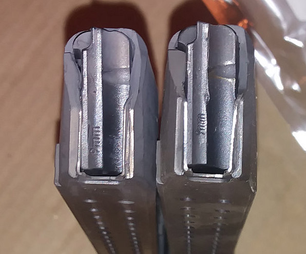

To get right to the point, companies have been knocking off Glock mags for how long now? They have been doing to for a long time and these folks still cant seem to get it right. Just put together my first PCC that uses Glock mags and I tried one of the SGM mags as the gun store owner said they worked great and were not the troublesome KCI but I bet they make these as well because they suck just as much. Photo added to show what I mean.
On the left is real Glock mag with the round properly sitting between the feed lips and to the rear of the magazine. On the right is the probably Tonk made as well SGM fagazine with the ammo not touched on either side by the feed lips and sitting farther forward, just loose enough and far forward enough that almost every damn round misfeeds and slams into the barrel below the chamber forcing the bullet deeper into the case.
So in short they are pieces of crap just like the KCI magazines where you need to buy 100 of them to get 10 that feed right. If only they spent another ten cents and got their metal insert right as well as their injection mold set up right but I guess that is too much to ask for a $20 magazine.

Even empty it is obvious this magazine is way off. Returning it.

I am sticking with Glock. The SGM I bought worked fine the first range session where I loaded it with 30 3 times then the second and third session the feed lips opened up and problems started. I have looked at several brands that are all plastic so I may as well just get it over with and buy Glock as when these fail I will have to buy Glock then.
