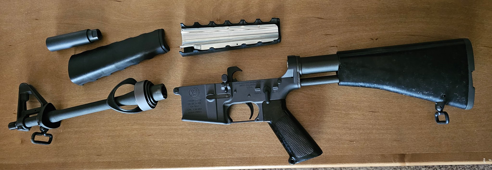

Well, here's some of the build so far...
H&R GX-5758 receiver
H&R LPK
A1 original grip
ORI 607 stock from original A1 stock, cut
cut-down triangle handguards
custom retainer cap for slip-ring
Colt C MP 11.5" barrel cut down to 10" by ADCO and gas port adjusted
Colt FSB w/A1 sight
Brick 607 moderator w/rebated muzzle end to look like the real one
Still waiting on:
- H&R A1 upper receiver (no shell deflector, but has teardrop FA)
- chromed BCG
- appropriately sized (thickness) split/lock washer
- Approved F1
The funny thing is I originally was planning on doing this in a way to save money and get the same general look, but decided that if I was going to do this, I wanted to do it right... so I have a bunch of parts that I started with and decided to not use them... things like triangle carbine handguards that don't need the custom retainer cap to use (ie, not cut-down ones)... an A1 upper in the wrong shade of gray, and I was going to just use the 11.5" barrel (to avoid cutting a Colt commando barrel and have the improved ballistics of an 11.5"), so I got some XM177 flash suppressors that would slip over the outer portion of the barrel with the threads further up...

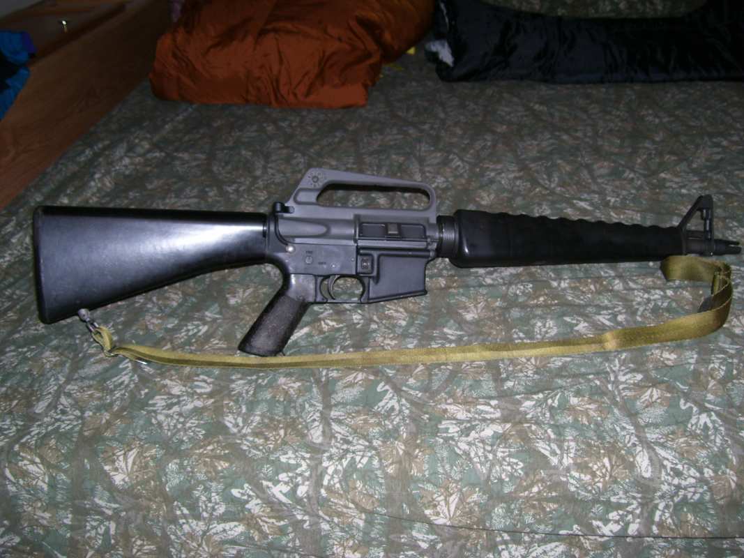

I built a 605 clone, this one is a dedicated .22 using a Spikes barrel. Since the chamber is deeper in the upper receiver, it's the original overall length with a 16" barrel.Lower receiver is late, but it's close enough for plinking.

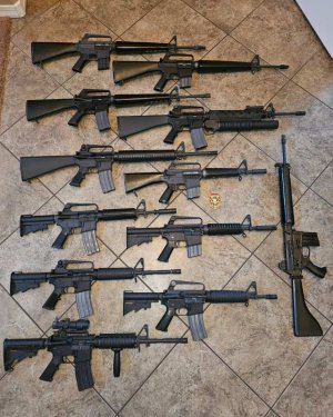

Pic of the finished 607, with a few other of my retro clones.
