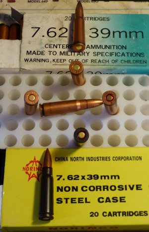

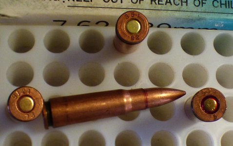

The first picture is a group shot showing the Chinese loaded ammo I have on hand. Three of them are copper washed steel cases and look pretty much the same, the Norinco yellow box has black steel cases.
The commercial Blue Box w/head-stamp 351-92 (factory/year) does not have a brand name but says it is made to military specs.
Primers are brass but do not have sealer. I do not see any sealer at the neck/bullet either but there is a very slight groove in the bullet perhaps where sealer would go or a crimp area The bullet tips are strongly magnetic suggesting a steel core (which I believe is the case).
The Norinco Yellow box (black steel case) is marked 71-89 and it too is strongly magnetic. The primers are brass colored and have a red sealant. The bullets have the same slight groove and under a magnifying glass it appears a clear coating has been applied- perhaps lacquer.

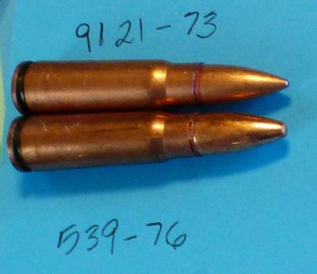

Now the interesting part... I have two lots that came out of spam cans.(one I bought and another I split with someone else), both are copper washed steel and look pretty much the same. Both have red primer sealer and a red ring at the neck/bullet. Shown here on the left/right with a side view in the middle.
The first sample is marked 9121-73 and the bullet is a pointed spitzer like the previous bullets above.
On close inspection it has the slight groove in the bullet at the mouth and the red sealer can be seen on both case and bullet as a even ring at the mouth. The bullet is strongly magnetic.
The last example has head-stamp 539-76. Although a spitzer bullet it's point is more blunt and the ogive taper appears different from the 9121 version. Looking at the case mouth shows a definite crimp not seen on the others and the red ring is applied in this area . I don't see the red at the bullet/case juncture so maybe it is hidden inside or maybe the red ring is to make it look like it's sealed. The primer has the red sealer. The bullet IS NOT magnetic at all. This surprised me. This bullet may be a cheap knockoff made to resemble milsurp.
What is interesting is the 76 in the head-stamp, IF it is in fact a date, that is way before the ban, else it must be a code of some sort.
Looking closely at the bullet, it appears to be plated, little dings show how soft it is (indicating lead) but the plating is intact. Again, this bullet IS NOT magnetic at all.
So AZGeezer is correct... some is, some ain't... however in this example, the bullet jacket isn't Cu washed steel, but now I don't doubt there isn't some out there...

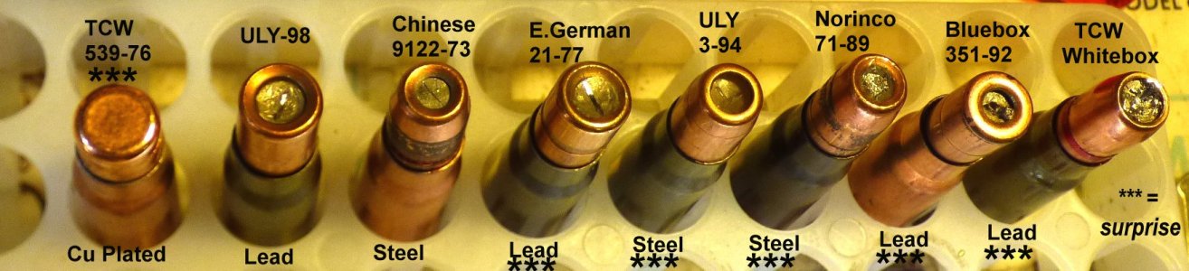

OK then... Since enquiring minds want to know (aka mine), I decided to sacrifice the above rounds to dissection, especially since I can reassemble them. Also, since I'm going to all this effort (can ya feel it) I dug deep and added four more of some other stuff I have laying around... like East German M43 surplus (the box says made in Germany but the head-stamp indicates Hungary).
Who knows, ya might run into some at a show... Most was bought in the late 90's early '00 which is when my interest in SKS/AK's started- so it is likely lead core.
Here is the summary... I'll try to put the data in a table for easier comparison if the editor will support tables, if not, well crap, formatting is not fun...
OEM ..... cOAL....... Wt.Type... Brand........... Powder... gr... avg-fps... Magnetic... base... bOAL... Bullet.... Note
Russian 2.172".....122 JHP...TCW 539-76..... Extruded...24.2gr 2347fps No FB 0.809 Lead Core Cu.plated lead
Russian 2.158".....124 JHP...Ulyanovsk 98.....Extruded...25.7gr 2379 fpsYes FB 0.875 Lead Core
Chinese 2.189".....123 FMJ...Chinese 9122...Extruded...24.8gr 2318fps Yes BT 1.05 Steel Core
E.German 2.183".....123 FMJ...M43 21-77.....Extruded...23.9gr 2336 fps Yes FB 0.903 Lead Core white box
Russian 2.147".....124 JHP...3-94 (Ulyanovsk)...Ball...25.5gr ... Yes BT 1.03 Steel Core purple stripe box
Chinese 2.193".....123 FMJ...71-89 Norinco...Extruded...24.7gr ... Yes BT 1.05 Steel Core yellow box
Chinese 2.175".....123 FMJ...351-92 Bluebox...Extruded...27.2gr ... Yes FB 0.91 Lead Core
Russian 2.175".....122 JHP...TCW Whitebox....Extruded...24.5gr ... Yes FB 1.034 Lead Core white box
During dissection there were several surprises...
results that were not as expected are marked with *** in pic )... click to zoom
o- ALL bullets were magnetic except the one Cu plated unit.
o- TCW 539-76 is a copper plated lead bullet- I am surprised they were doing that back in 76.
o- E.German M43 21-73- I expected this to be steel core- flat base lead core w/steel jacket.
o- Uly 3-94 HP.bt Steel Core- is this hollow pointed milsurp steel core? Also this one has ball powder.
o- Norinco Yellow box 351-92 I was surprised this is steel core. Base of bullet has a thin lead wash but steel under.
o- Blue-box MilSpec- I expected SC but nope- lead core Also 1.5gr more powder than others.. milspec?
o- TCW White-box- A 122gr HP.bt lead core that is as long as a 124gr FMJ.bt steel core - How'd they do that?
Overall I would say this was an interesting exercise and I now view surplus 7.62x39 much differently.

That was very helpful Muzap... thanks
Do you have any thoughts on two of my Russian samples?
1. 124 JHP, 3-94 (Ulyanovsk) head-stamp, w/25.5gr Ball powder. Came in a white box purple strips ... The boat-tailed bullet does have a steel core and is of similar length & profile to other steel core except it is a hollow point. Also this is the only one with ball powder. I read somewhere that they did hollowpoint some existing FMJ, but for a hunting round (marked on the box) I wouldn't think they would use steel core unless the packaging was just marketing to get my Rubles.
It is interesting the date code is 94 - if the law was passed in Feb then it probably had 6 month until it went into effect. This stuff just squeaked in the window, or else it uses a very very hard lead my pick couldn't scratch (and I bought it 5 years later still sealed).
2. 122 JHP, TCW White box- This FMJ.BT bullet is 1.034" oal just like the steel core but is lead core and weighs 1gr less than the shorter lead core... how'd they accomplish that? perhaps filling the tip with something light? This is one I might have to cut open.

The steel core stuff is of such a mild and soft steel that it is nowhere near "armor-piercing" in quality. At most, it retains itself better when cutting through light skinned auto bodies than the lead cored stuff, but only by a slight margin. Interestingly, the Chinese got their quality control in the steel core manufacturing process so good that for a time during the late 80s and early 90s, you could occassionally score Chinese "match" 7.62x39, and it was steel core. (For them, "match" was 2 moa vs typical 5 or 6 moa). It usually sold for the exact same price as all the other blasting stuff, at 7.5 cents per round back then.

I saw a YouTube video where the stuff went thru a 1/4" steel plate but not 1/2", so that is probably where it gets its armor piercing nomenclature... of course the steel was probably mild steel and not AS500 or other hardened armor plate. I'll make sure I'll avoid 1/4" steel body armor and only wear the heavy stuff....
Re: Chinese Copper Washed AK/SKS Ammo
Those both sound odd. I've never heard of a steel core hollow point 7.62 x 39. Maybe drilled after it left the factory? I'm definitely no expert, though. I ran into the page I linked several years back when I bought an unopened spam can of Chinese steel core from a private party. I'm not sure if I'll even ever shoot it - as mentioned above, it's definitely corrosive, although I usually clean after every shoot anyway so it doesn't make that much difference to me. I do know, from what I've shot of some loose rounds I have, that it has noticeably more "punch" than contemporary Russian ammo like Wolf and Tula. Someday I'd like to chrono it next to the Russian ammo just to satisfy my curiosity.Harrier wrote: ↑July 25th, 2018, 7:57 am That was very helpful Muzap... thanks

No its factory ULA- 1000 rds came sealed in factory boxes
