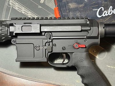

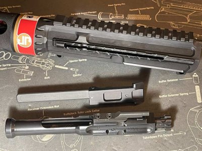

I just got a JP rifles side charger. Mainly to shoot suppressed and minimize gas to the face.
It's odd right now but I'll get used to it.
