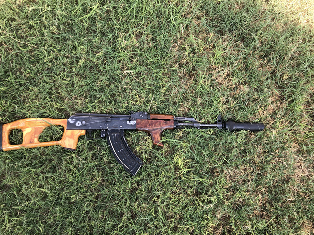

You got people making aks with cast parts and no skill so be cautious where and what you buy. Stay away from US part builds with cast crap. US made is ok from a GOOD builder not some PSA bs. A real Ak don’t need a lifetime guarantee cause it guarantees your life.
Here is a romy bastard a buddy and I slapped together for your viewing pleasure.
