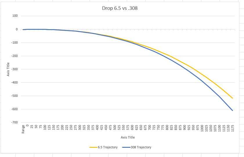

If you just want to start shooting long range competitions you absolutely "can" do it with your .308. That cartridge will put lead on steel at 1000 yards. If you are going to buy a new gun for the purpose I'd not choose the .308 cartridge for the new gun. For what it is worth - I'm not down on the .308 / 7.62X51. In fact my first "battle rifle" was an M1A and when the interwebs asks the question "if you could only choose one cartridge to take with you into the dystopian future what would it be" I've answered that question with the fact that I'd take a .308 battle rifle. I think it is a fantastic cartridge that covers a whole lot of ground including shooting things at longer ranges. That said, being my choice of caliber for the zombie apocalypse does not make it my preferred caliber for competing in a long range shooting event. There simply are better options.
For giggles I went out to Hornady's site and pulled ballistic data for their 140gr ELD Match 6.5 CM and their 168gr ELD Match .308 cartridges and plotted their trajectories against each other (yes - there are thousands of different combinations that could be compared - I just grabbed the two that were the "common" ELD type factory cartridges). The plot through 1200 yards is attached. In short - at 1200 yards the .308 has dropped 611.1 inches and is moving at 1140FPS and the 6.5CM has dropped 517.5 inches and is moving at 1339 FPS. So - you've got almost 100 inches less drop and 200 FPS more velocity out of the 140gr 6.5. This is just "better" for long range shooting. The faster and flatter the round is, the less adjustment you need to make at the scope and the less time that it spends being manipulated by moving air (less impact in terms of windage).
So - I'll align a bit with @BAD BOY and say that it might be smart to go shoot a few weekend matches with your Rem 700 .308. Buy glass that you can grow with, and figure out the twist rate for your barrel and shoot the longest heaviest match bullet that your barrel is likely to stabilize. If you enjoy it, do it a bit more and when you have learned enough about the game to be able to truly say that your equipment is limiting you, then go buy the next thing. If your budget is what you say above then I'll stick with my advice from the previous post. On the other hand - if you win the lottery - go build yourself a competition rig in .375 CheyTac or .416 Barrett...
