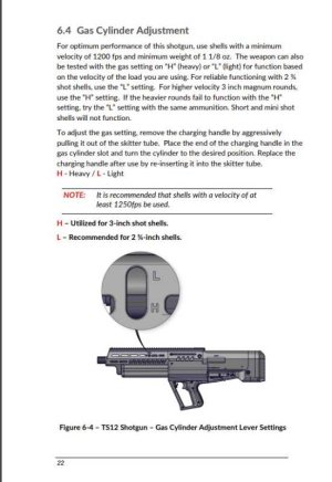

OMart wrote: May 25th, 2022, 12:06 pm Sold a bunch of them. I have heard they need buckshot or slugs to cycle properly unless you change the spring.
My kid has put a bunch of basic birdshot through them. The only thing he's told me that it gagged on was some "low recoil / low noise" target ammo. Everything else, mostly whatever is off the shelf at Walmart, but also some defensive 00 Buck etc, has cycled just fine.
It has an adjustable gas system - and setting the gas system to "L" (light) is necessary if you are shooting non-magnum cartridges. I wonder if the folks saying that it would not cycle unless shooting buckshot or slugs were shooting it with the gas system on H (heavy) but with lighter rounds. Pic from the manual...
Little different than what I have sold but good to know. We sell this https://www.rsrgroup.com/product/JTSM12AR-B1 but some of my customers are "special" and I don't think they always read the manual. It appears it also has and adjustable system. I will pass along the info. I do know they were shooting Winchester 8 shot from Walmart from the 100 round mega pack. Who knows how old it was because I have not seen that ammo in a minute.

I bought the JTS m12ar and manual states it needs 1250-1300fps to function which seems to check out in my trials. Found Winchester 00 buck 2 3/4 for sale at PSA and it functions fine found a #4 plated turkey load at Scheels for reasonable price for plinking with. The low recoil buck I had jammed it up.
