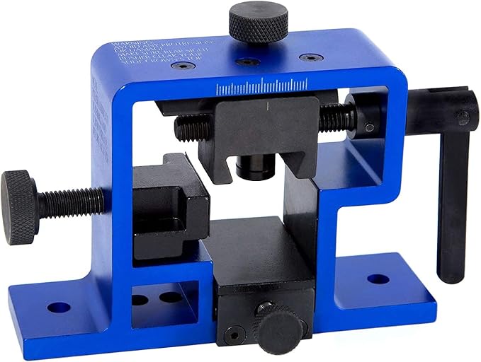

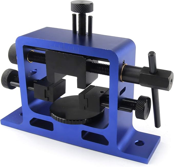

They really aren't that expensive. I put sights on many of mine with this
Or this

@kenpoprofessor - the tool that you posted is the one I saw when looking for sights on Amazon. Sounds like it is doable with that tool - without huge risk to the gun. If I end up doing them I'll pick up one of those tools.
@QuietM4 - Thanks much... agreed - no desire to ding up the gun. If the store will do it with purchase I'll probably go that route. If it's going to be more than buying the tool that Kenpo presented then I'll buy the tool...

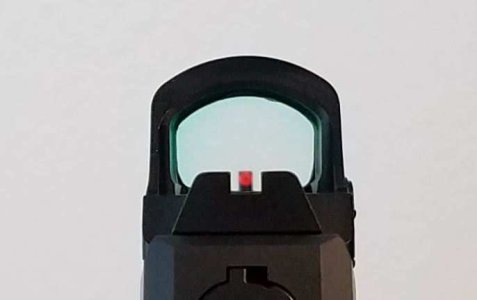

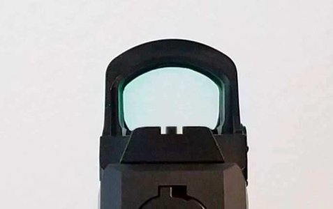

As I read up on this topic I just could not get myself to the place where I was comfortable without having some sort of physical aiming device should the RDS fail. If, when I take a class, they provide alternate options - I may roll back. But until then - I picked up a set of Ameriglo sights that are slightly taller than stock but shorter than suppressor height sights. The back sight is solid black and the front is green so its visually distinct from the red of the RDS. This is a clip from a picture on a Walther forum showing what they "should" look like.
I also picked up the rear sight push tool and a $10 front sight tool (from Ameriglo). I figure there are enough pistols in my life that having the tool for the rear sight is worth the money.
I'm looking at classes on shooting with an RDS - and think I'll just dive in a bit. If the new sights present as shown in the picture I'd like to think that they won't distract from the dot. If they do - I can put the stock sights back on and use the Ameriglo's on a different gun.
